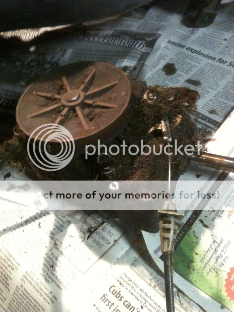

I have a Honda HRR216TDA. Would it hurt anything to spray WD40 in the gear shift lever to make it shift a little easier?

Wouldn't hurt a thing.
Come to think of it, while you have the mower over on it's side to clean under the deck, take a moment to check the area around the transmission as well. Grass and other debris can get caught up around the top of the transmission and that might also cause the shifting to be a bit stiff as well.
This is the same transmission you have in your mower....
Before....
After....
Not that it has to be all spotless like that, and you don't have to take the transmission out of the mower to clean it up.
Would be alright to free it up but, long term, I would use a light grease/oil or graphite as it would not evaporate. Honda may have a recommended product to use as well. Some Honda guy may have some more input shortly.
Before....
After....

You will see when you look at your HRR216TDA you'll see that the cables are solid wires, pretty much, that run through the sheathing. WD40, PB Blaster, or something like them will work just fine to lube them up. You can pick up cable specific lubes at a motorcycle shop if you want, but, eh...
