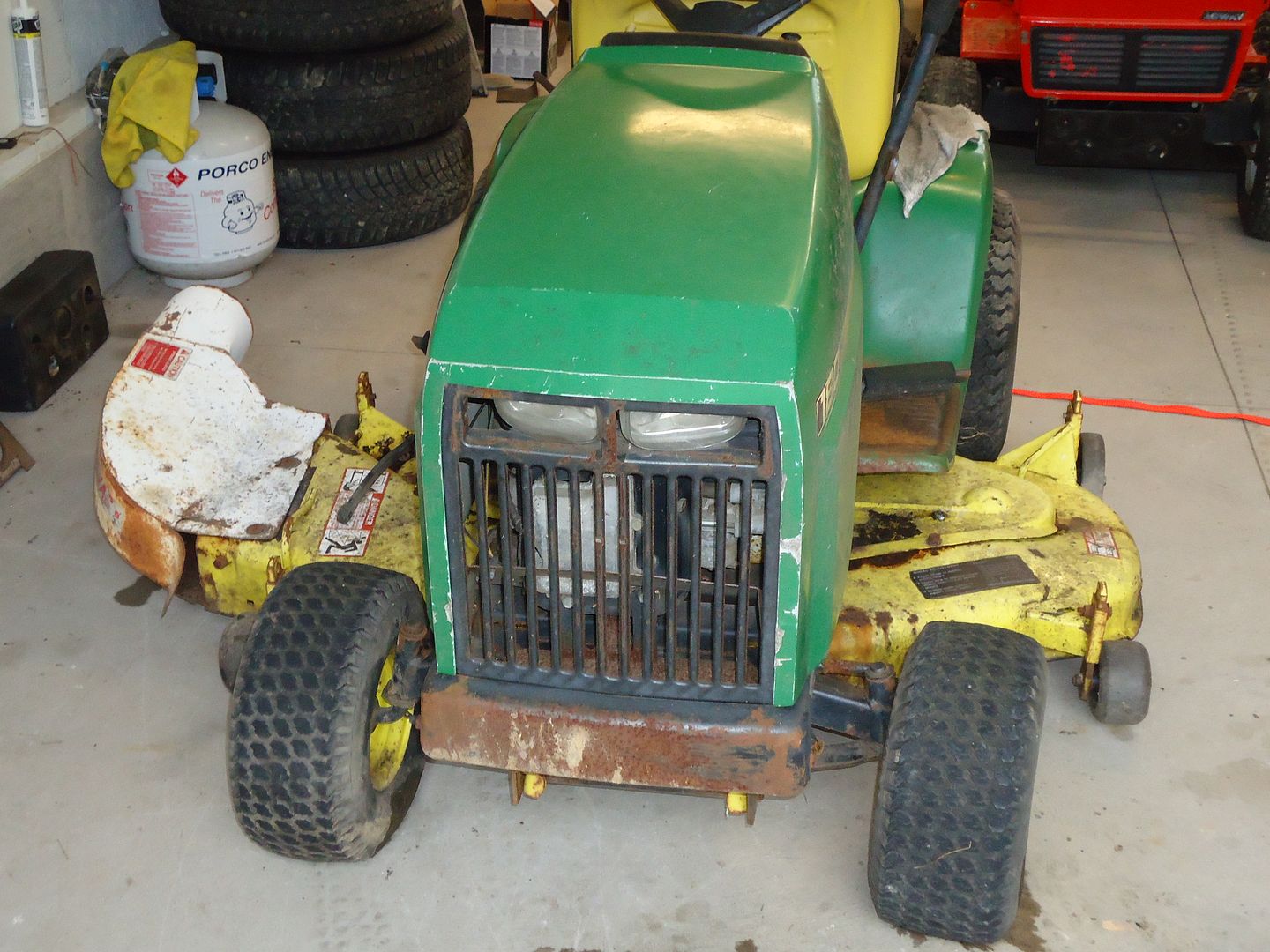

Hi guys, thought a good way to introduce our work/ ourselves is to show you! This is our first restore which we kept! It is way too big for our yard, but I really like it! It was given to us by a Facebook childhood friend of mine. His father owned it untill he passed. Here is how we got it! It was rough and didn't run. We went through it and learned as we went! We got it running and tried it out before painting it. We got it done and tried it for the first time mowing, and the transaxle litterally blew up! A bearing seized internally. We found a replacement would cost $600! We found a similar Peerless trans out of something for $50. Dad took our good gears and swapped them into the case of the new one. Works good,second skipps a little. We left it alone. It is a nice machine and we are glad to have it!

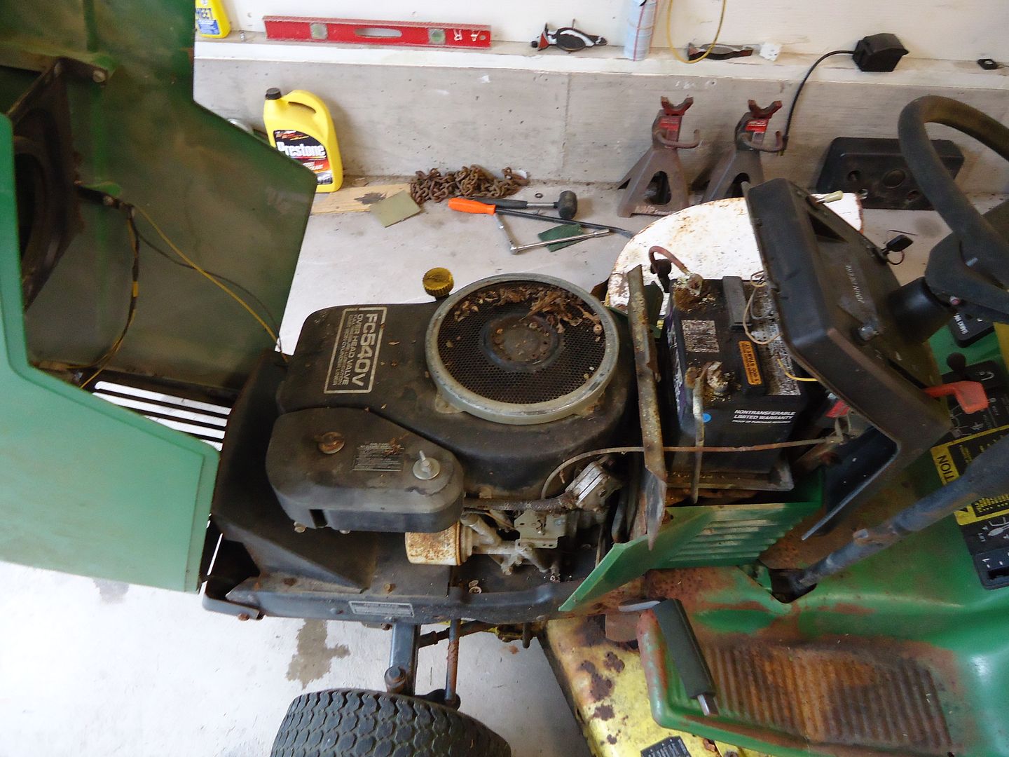

Maybe I am the old man then !! :) Here is some more of it stripped down at first! Some pics of the bearing and shaft that killed transaxle on first trial mow! Some of the beginning build I found!
How did you like playing around in that nasty grease? What type of grease did you put back in it?
Hey guys, Five, we used some of the factory benonite and wheel bearing grease due to that bearing seizing. Made us think that thick grease was worthless in some ways. Dad put in a new bearing instead of the factory bushing it had. Dr Bailey, just old fashion sandpaper and sander, sometimes hand work! The most fun part :( NOT!!
