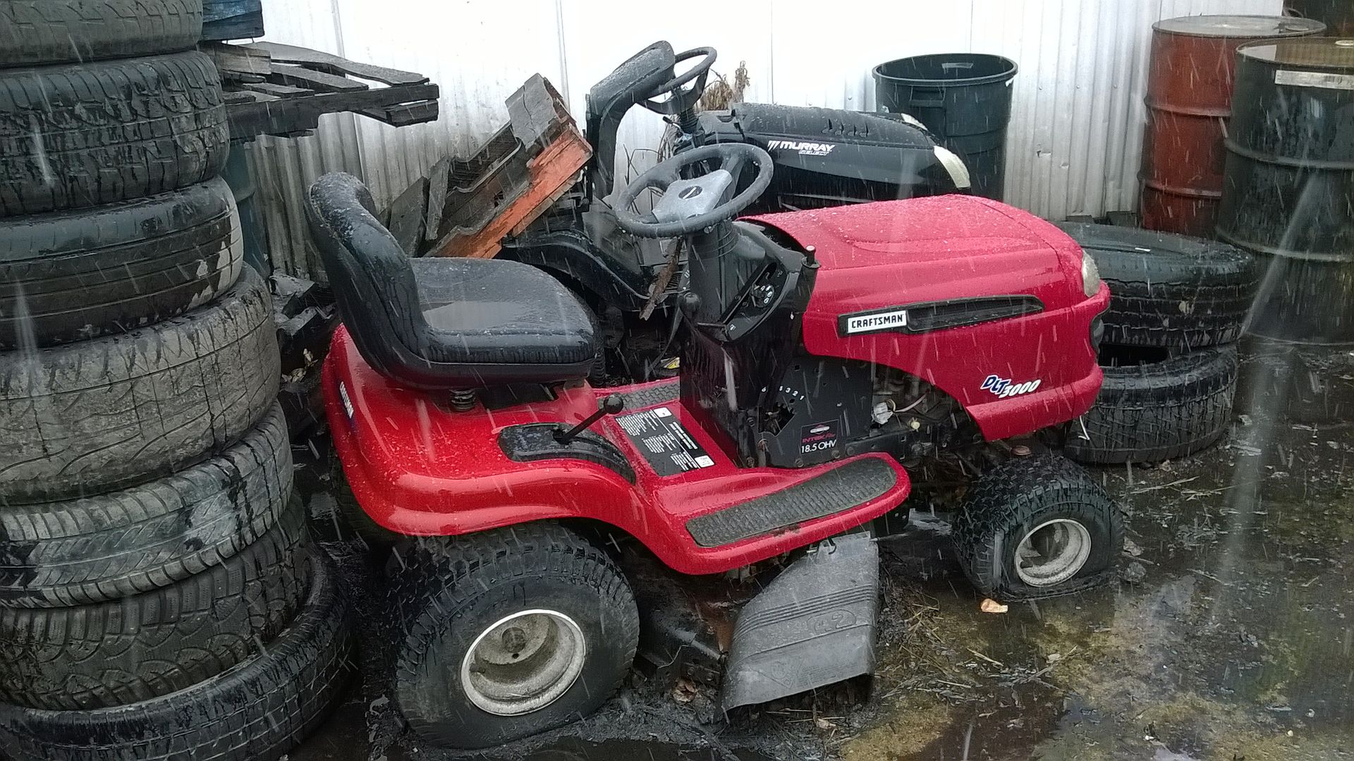

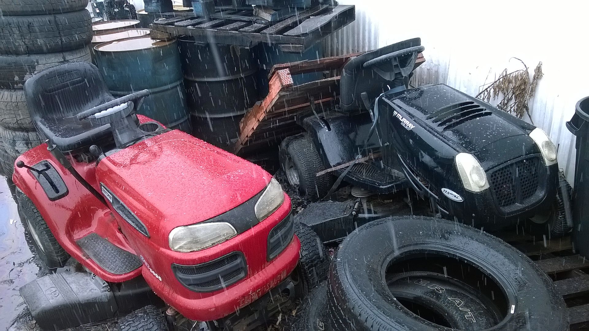

Hey guys, had this in a separate thread and never started one for it. We got it with blown engine and terrible shape paint wise. Dad was building it for the local firemen. Dad installed new engine and repainted machine. Full service/ paint on deck. We loaned it out to friend we swapped engines for and the fireman friend when his machine needed work. Well my friend returned it Thursday night to get his in Dead condition. Said it would not start after using it. He installed new plug and nothing? Dad looked it over yesterday and found spark and fuel. He also found a mouse nest on magneto area. Think it was overheated and blew headgasket/head :( .
The engine was starting to smoke and never ran as well as we liked anyway. We will set up firemen with the Gray Craftsman instead.
My buddy Bob gave dad a engine for it and it is a SWEET one! Twin Briggs! Should make it a nice machine for sure! UPGRADE!
How we got it.
The old engine.

We had a lot of work to get it going today. The Throttle cable needed replacing and a choke cable was required. The muffler and piping was a chore as we did not know which ones were needed. Turned out I had three different sets of piping, we installed wrong ones first and caused all sorts of issues! Finally got that sorted and tried to fire it, only on choke cleaner. Dad took carb off and had heck of a time removing bowl screws. Got it cleaned and it fires and runs good, governor is acting sticky and revs too high. Might need adjusting or just running for a bit?

We did go out and spray PB onto linkage and governor shaft. Also mounted tins and installed air cleaner. It fired nicely and something is off with throttle linkage, sometimes it was ok rev wise, other time it did not throttle up at all and cable is working as is linkage?? Will print schematic of linkage and look at governor adjustment if necessary. We let it run for 5-10 minutes and I drove it around so far so good otherwise!

We adjusted the governor and think it was sticking also. After mowing yesterday it seems to be running very well. Bought a air cleaner for it today and need to buff and detail it for sale. Will take pics/video tomorrow.
