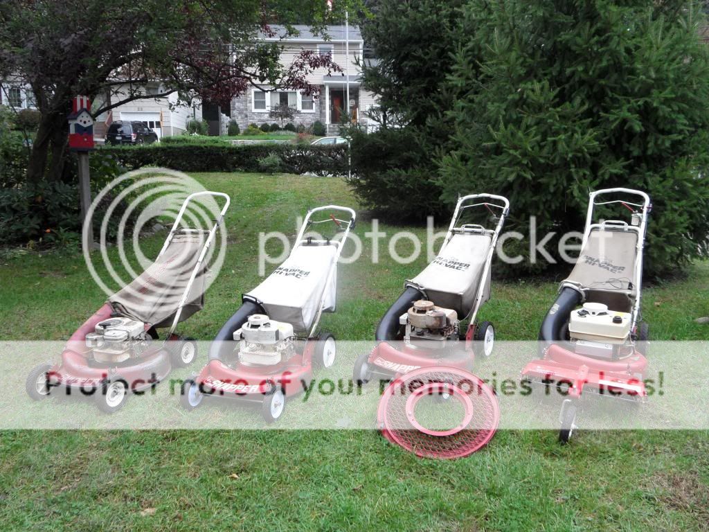

This picture is about a year and a half old. Only shows half the fleet of Snappers I now have!
I'd love to get a new picture of the Snappers, but the lawn is now home to my 1949 Oliver 88 Rowcrop farm tractor!
You are lucky you do not live on Long Island, I seem to buy every real snapper which comes up on craigslist at a good price!

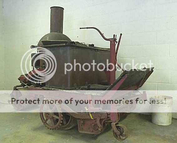

Here is an image of a 1901 Coldwell Steam powered lawn mower:

Yes! Mine has the same engine and makes the same clickity clank of the metal stone guard;-) mine could use a new blade, and rod for the drive lever handle( works as is, just tweaked like a pretzel). Needs wheels too, but I figured all that could wait a season or two yet. Maybe I should get a blade then if they are getting hard to find. Do the newer ones with the wings work on these? Or are the blades to big on the newer ones? then again, I guess you need to have an actual hi vac deck to take advantage of one of them. Nice collection though ktron. I hope my wife let's mine reach that point some day:)
130 Posts
The device in front of the mower you are talking about is called a SNAPPERIZER. It mounts to the blade, and when spinning pulverizes everything to an even finer material. Instead of ending up with a 40lb bag of debris, you can easily get 70lbs of dirt in the bag! The only downside to the Snapperizer is that you really need a healthy 4hp engine, or 5hp engine minimum for the task. The second mower in from the left has many thousands of hours on it, and although it is 4hp, it does not have the life in it to power the snapperizer effectively. It really takes a lot of power out of the engine. It does work really well though! The Snapper third in from the left has been bored 0.030" over and is governed to 3400rpm. I would say it makes ~ 4.25hp now and it seems to be okay with the extra load.
The mower on the far right has a Snapperizer and a Thatcherizer on it. The Thatcherizer sticks out front and as the machine moves, the spring loaded arms help clear and pull out loose pine straw and dead grass. All of the HiVac mowers have winged blades on them. The wings do not last very long. I run through about 4 sets every season.
