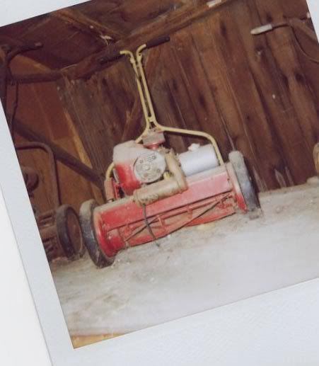

Here is a picture of an 18" Bantam with what appears to be a yellow handle,
There's a manual on ebay for the Bantam. At the bottom there is mention of the Johnston Mower Company, a subsidiary of Jacobsen, so maybe they painted theirs differently.
Now I've got the "wish I'd taken it" thing going on.
I think you're right, I was thinking that too.
