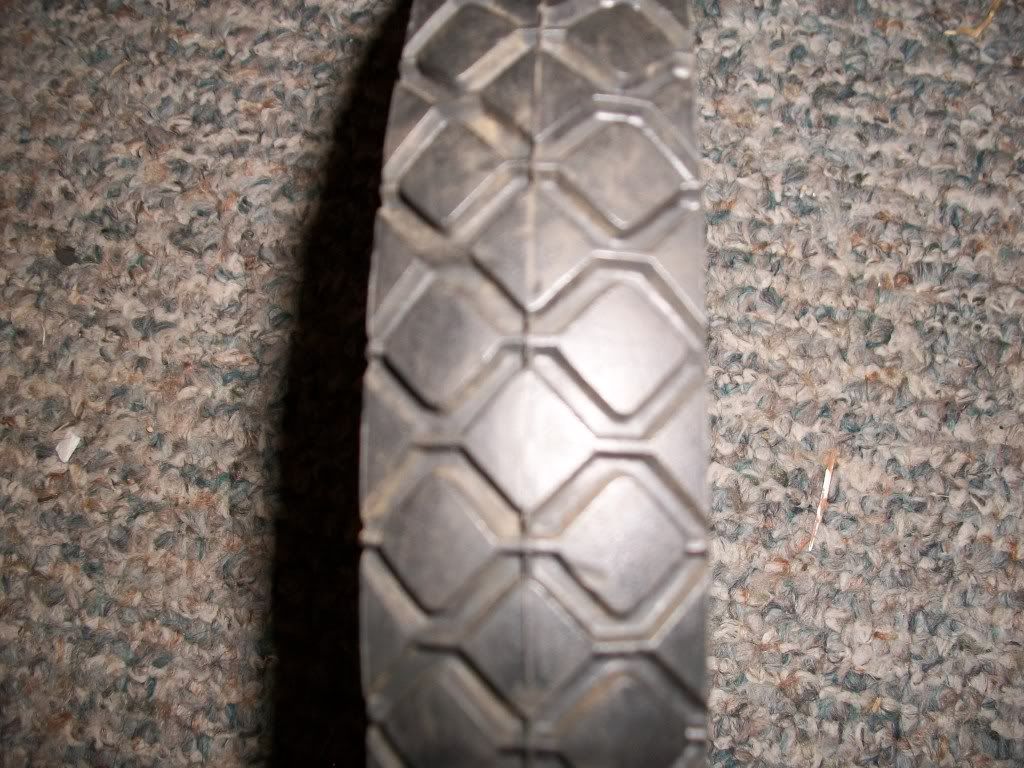

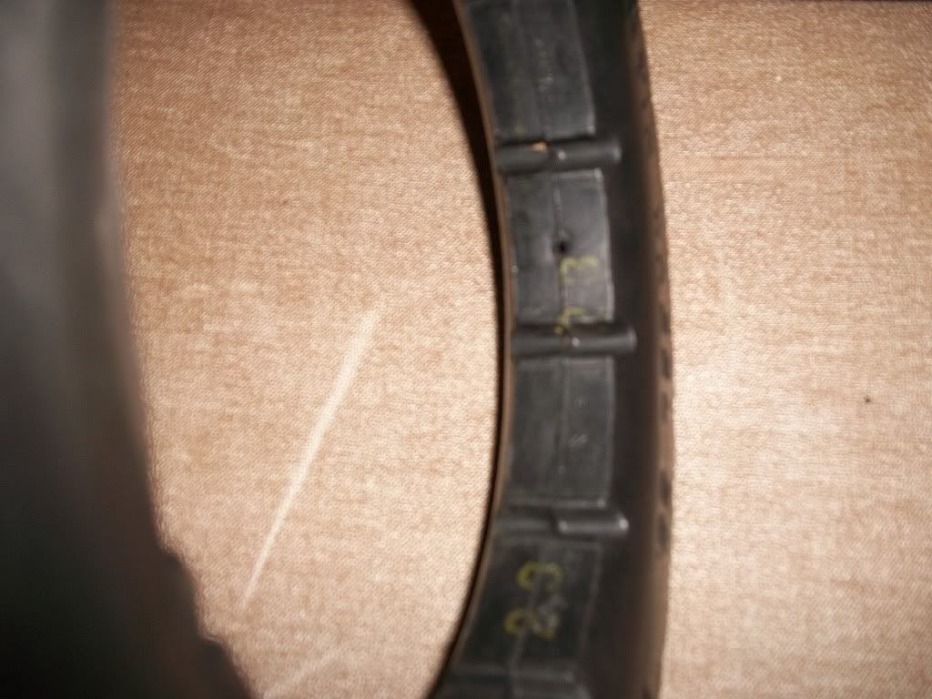

I am restoring my 1950 Jacobsen Lawn Queen. I have finally found replacement tires for this mower. The size is 10.50 x 1.75 which are very hard to find, I have been looking for months for this size tire , I could not restore this mower without them as the originals are bald and splitting down the middle.
My question is what is the best way to soften up these tires? They are hard and not very flexible. I was thinking about boiling them, but I am not sure if they will soften up enough. I would appreciate any ideas, thoughts or if you have first hand experience with replacing reel mower tires. Thanks.
Yup, soaking in them in boiling or very hot water for around 10 minutes will get them softened up quite a bit making them a lot more pliable.
They aren't the easiest things to work onto the rims, but take your time. A couple words of advice. Please use extreme caution should you decide to use a flathead screw driver or something similar to help work them onto the rims. The cast iron rims on these will crack EASILY if you do this... I learned the hard way on this and is why I had to originally replace one of mine. Also, keep in mind that if you stretch the tires too far when they are pliable, they will snap (again, learned this hard way) so take your time and use good judgement. I also lubricated the very edges of the rim with grease which can help the tire slide over the rim grooves easier. If you do this though, try not get the grease in the center of the rim which could possibly cause the rim to spin on the tire once it's mounted.
The way that I removed the old tires was drilling a hole with an appropriate sized hole saw drill bit all the way through the tire which splits it in half and from there you can easily just pull the two pieces off of the rim.

I think Austen boiled his to soften them. As I recall though it was still a real bear to get them installed even then.
