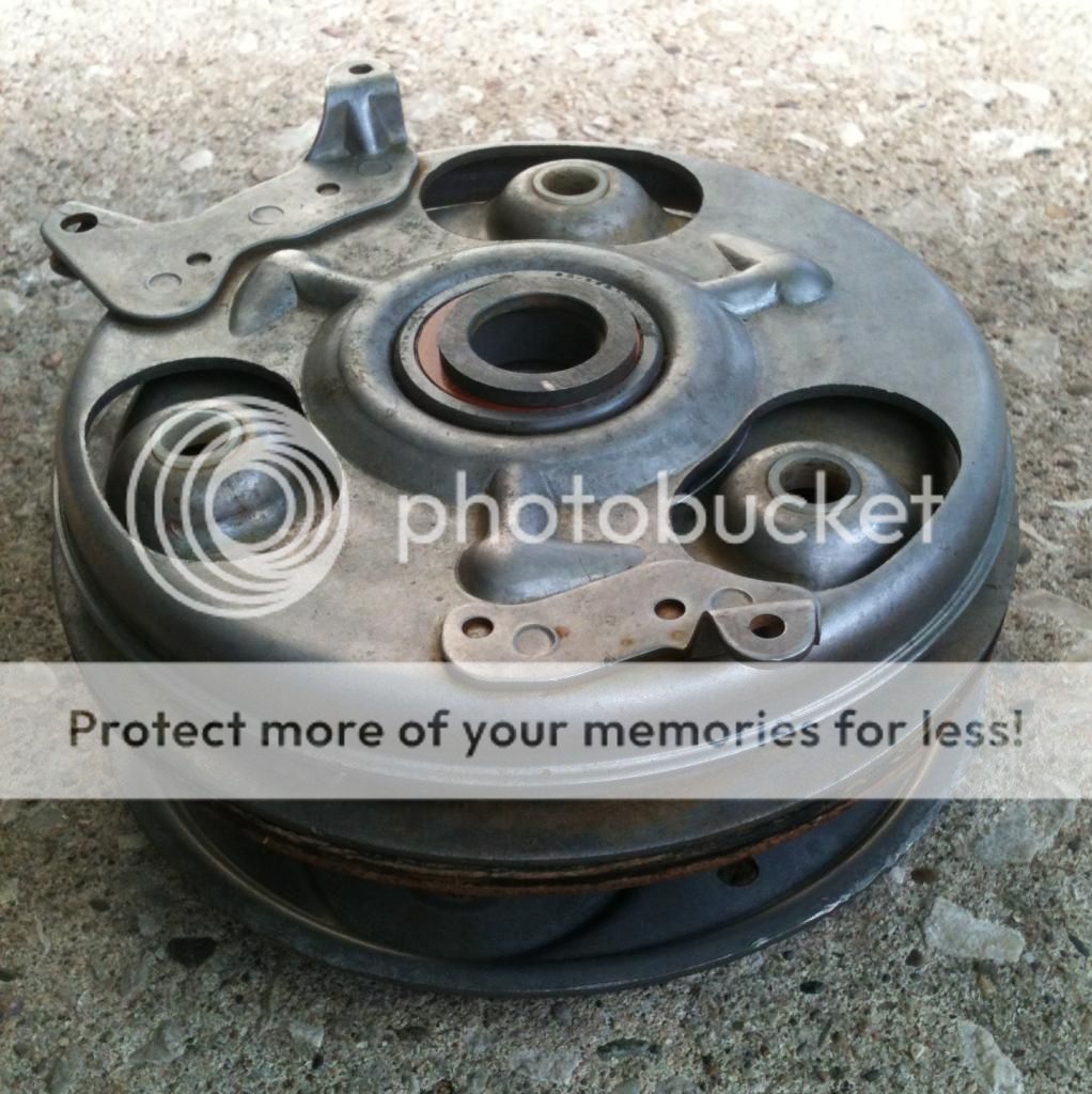

Each one had what is called a Roto Stop, a blade brake clutch, that allowed the engine to run independent of the cutting blade, and the blade was put into motion by activating a lever on the handle bar.

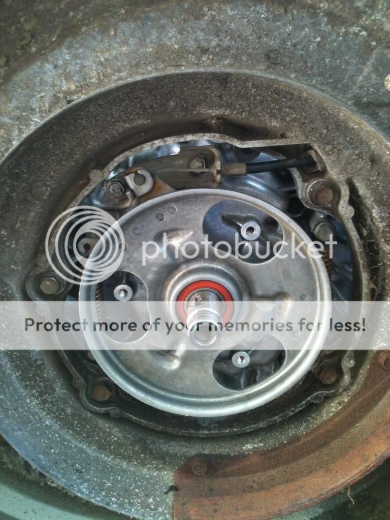

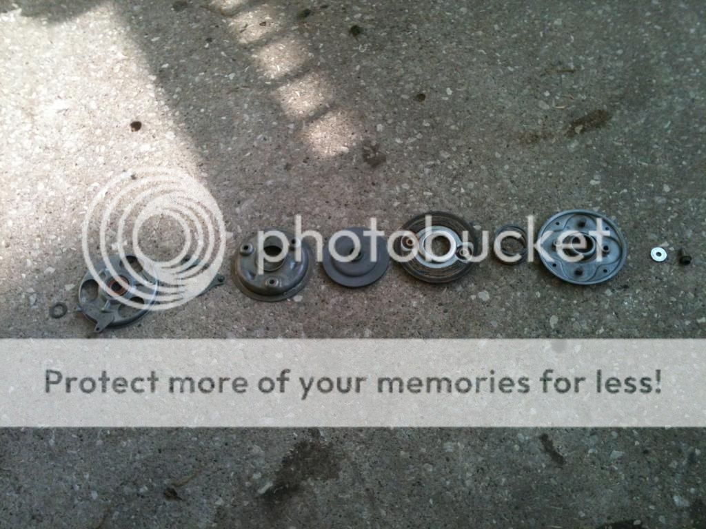

I'll start with the Roto Stop. It's made up of a number of pieces. Here they are laid out from left to right as the go onto the PTO of the engine.
And here they are stacked up as they will go onto the PTO from top to bottom.

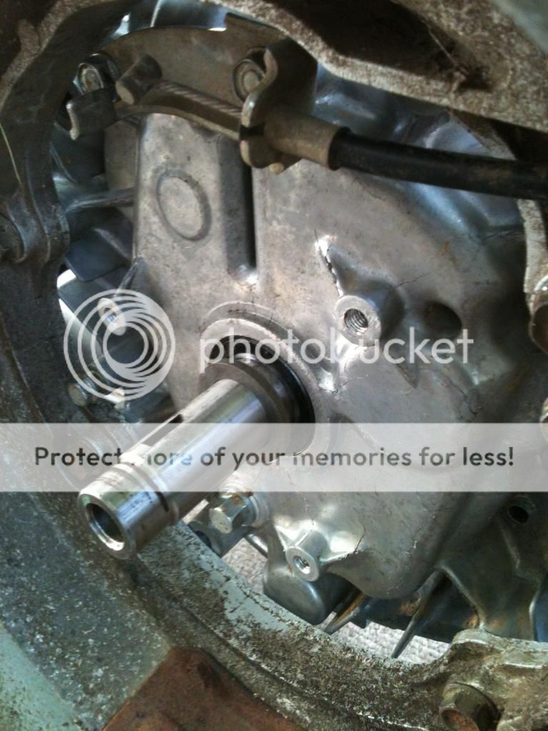

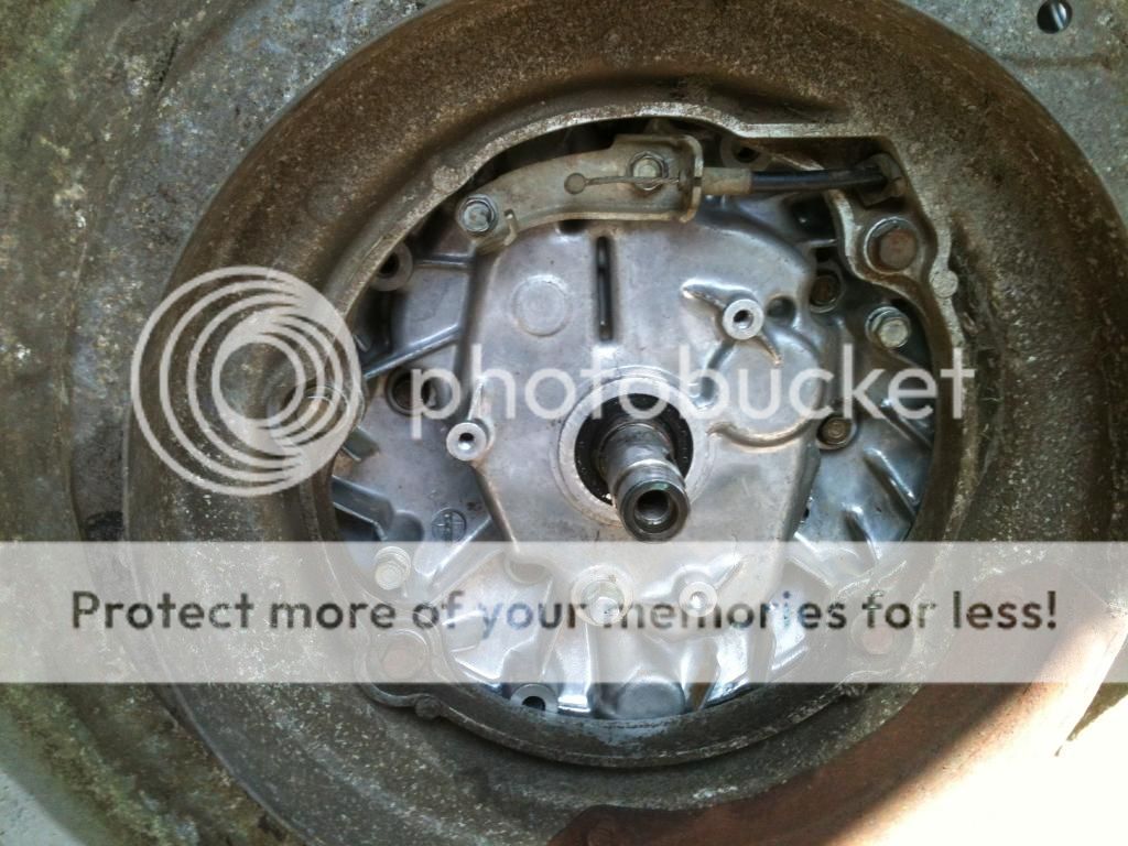

Laying the mower up on it's right side, you see the thing called an arm stopper, with the cable end, at the top, and bolts and spacers that the return springs will attach to on either side near the engine mounting bolts.
First thing to go on is a thrust washer. The manual says...Do not forget to install. It rests against the shoulder on the PTO and keeps everything else to follow in place as it should be in relation to the bottom of the engine.
Next is the part called the Ball Control Assembly. Notice the placement of its arm into the arm stopper and the cable end inserted into the slot.

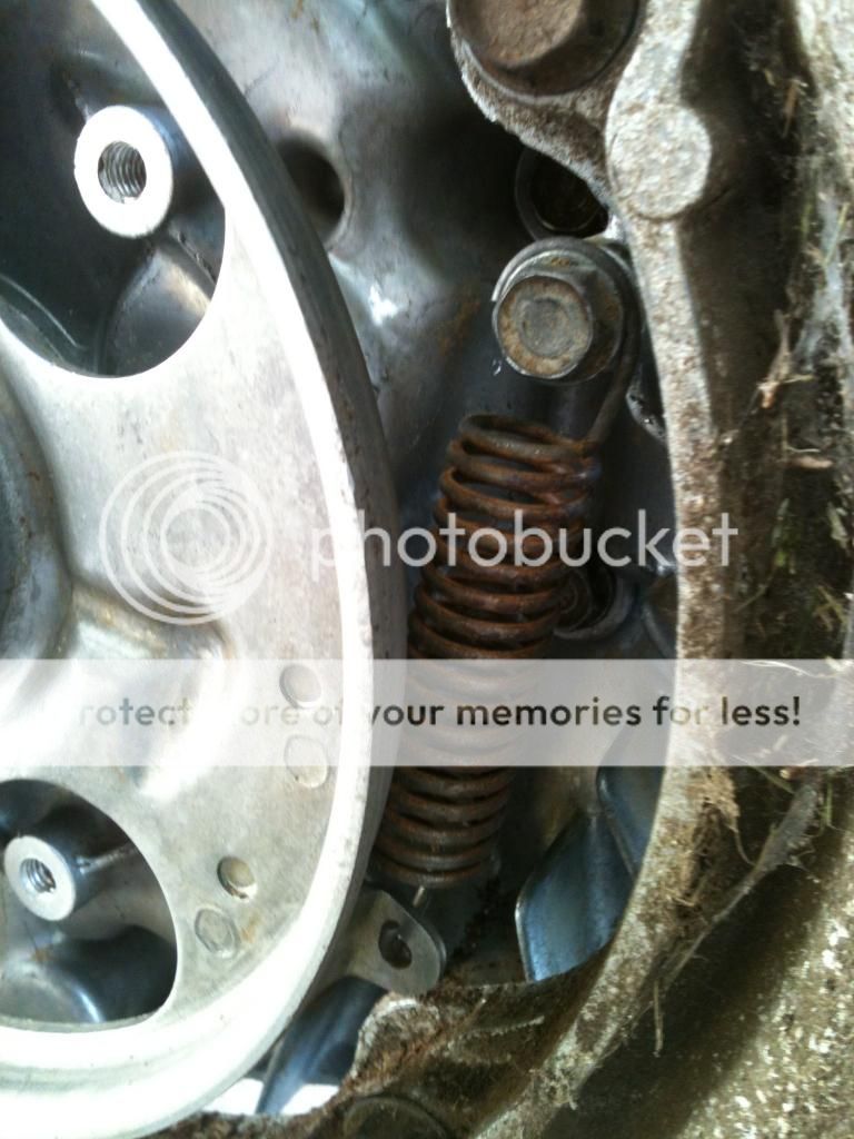

Then the return springs, one on each side. Hook them into the Ball Control Assembly and use a screw driver to hook them over their bolts and spacers.
You can kind of see them on each side here.

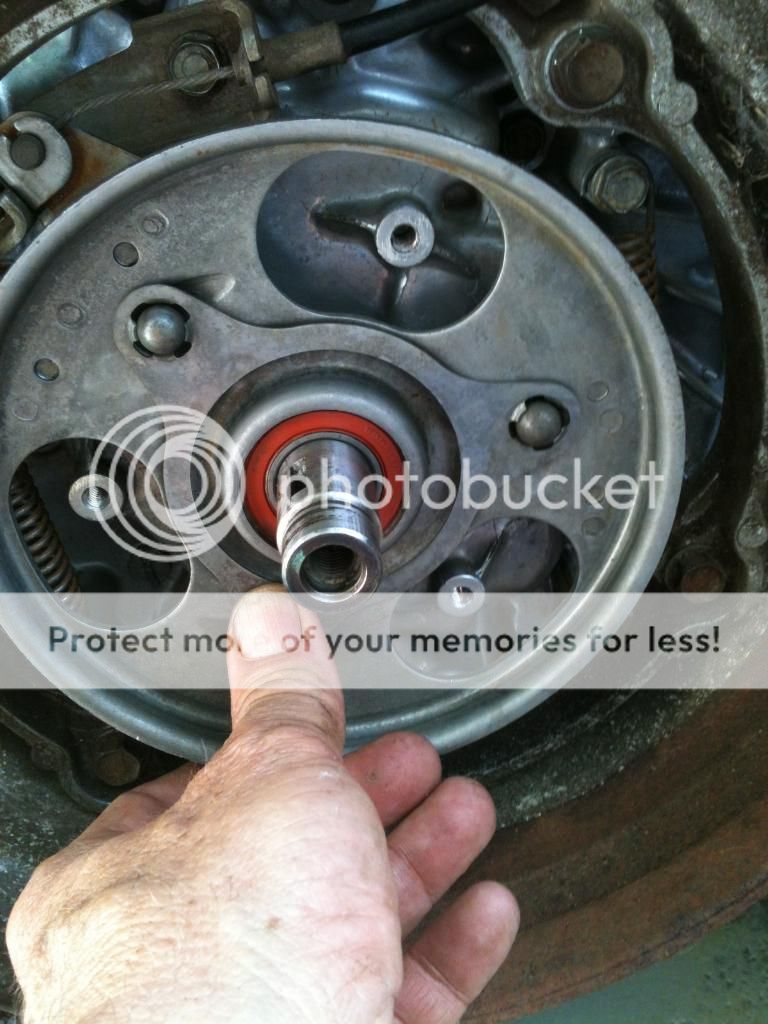

Then the part called the Ball Retainer. The three ball bearings fit into the recesses.

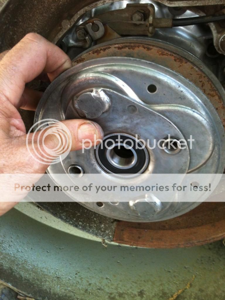

Then the Brake Disc. This part is what stops the blade and holds it. It also has detents for the ball bearings in the Ball Retainer.
The Brake Disc is held in place by three Brake Holders and Springs.

Next the Driven Disc. This is what is driven by the drive disc. Pretty much makes sense, but stick with me.

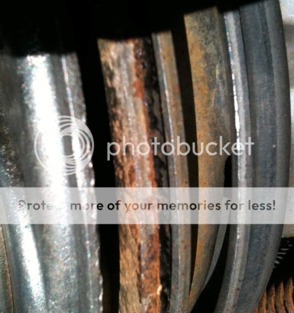

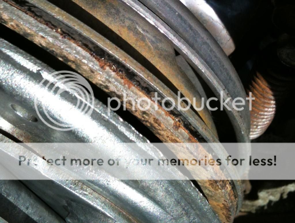

Here is the business side of the Driven Disc. Notice the two ridges. The one on the inside is what comes into contact with the Drive Disc and makes the cutting blade spin. The outer one is what comes into contact with the Brake Disc, and stops the blade. The service limit for those two surfaces is 4.6 mm each.

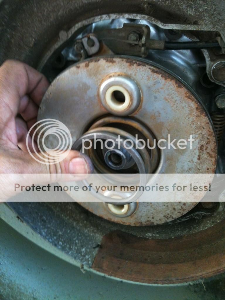

Next is the Clutch Spring.
Followed by the Blade Holder Assembly.

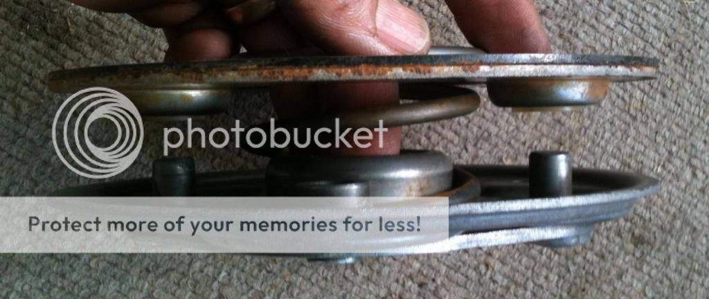

The Clutch Spring is compressed between the Driven Disc and the Blade Holder Assembly. The two studs on the Blade Holder fit into the two holes in the Driven Disc with the nylon bushings.
You push the bolt and washer against the Blade Holder with a 14 mm socket and wrench, compressing the Clutch Spring while eyeballing how the parts are lining up, and get the bolt started into the end of the PTO. Then you use your special compression tool, the length of rope in the combustion chamber, and tighten the bolt to 36.2 to 43.4 ft-lb of torque.
I don't know if you can see it, but I'v tried to show the how the Driven Disc sits against the Brake Disc in the first picture. Here the lever at the handle bar has not been activated, and the cutting blade will not spin. The engine would be running and the PTO spinning in the two bearings that you saw in a couple of the parts.
In this picture, the lever at the handle bar has been activated. The cable pulls against the BAll Control Assembly allowing the Brake Disc to pivot on the three ball bearings, raising it away from the Driven Disc. The Clutch spring pushes the Driven Disc against the Drive Disc, and the blade spins. The distance things move isn't much, so it's hard to tell the difference in these pictures.

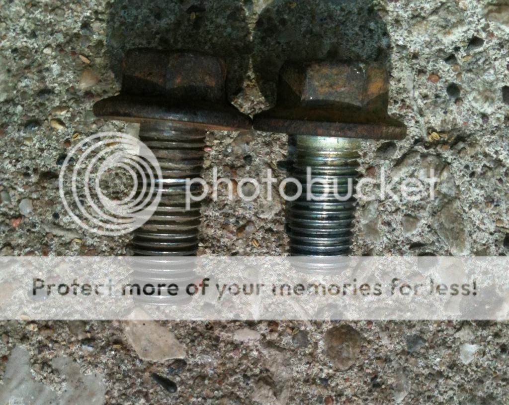

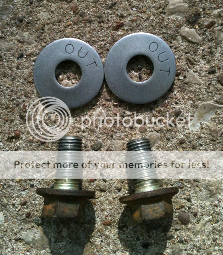

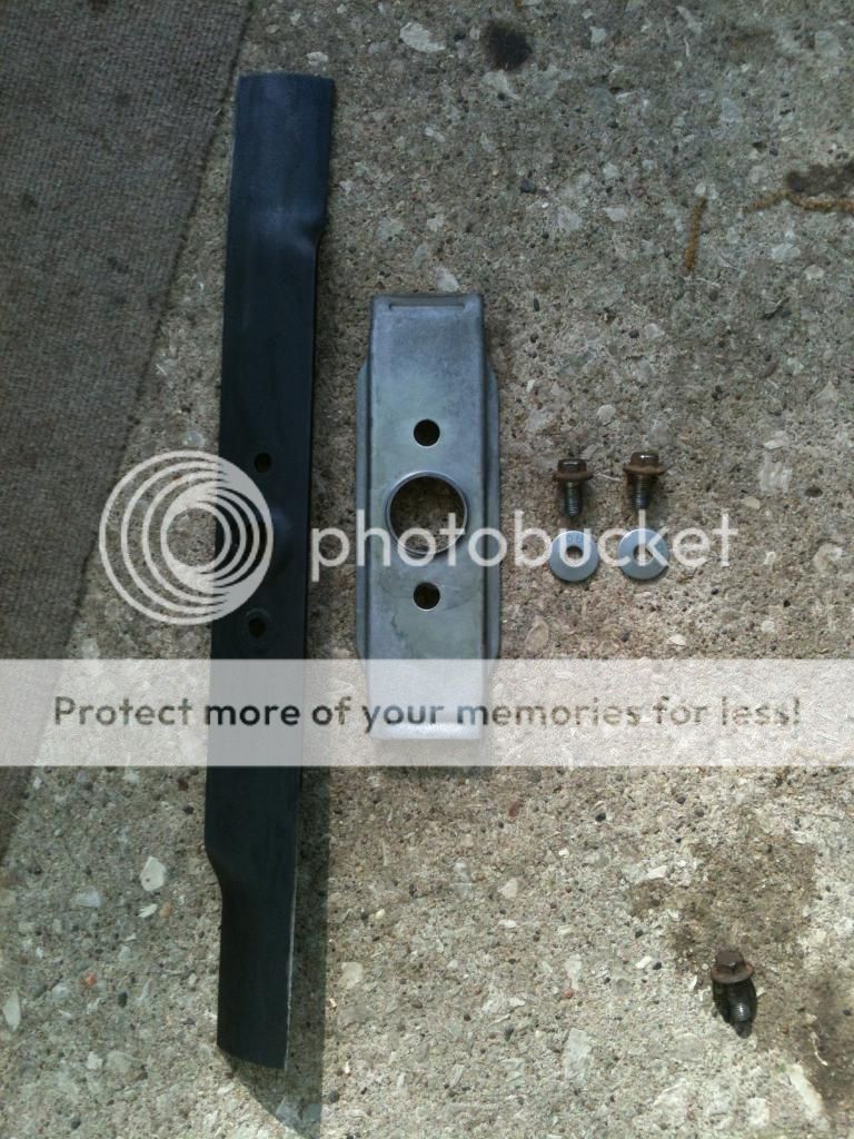

Finally the blade, and blade holder are attached to the Blade Holder Assembly with two bolts and two special washers.
In this case, I used a single blade and the blade holder. This set up is best suited for side discharge or bagging. A second blade would be installed on top of the blade pictured for mulching, and the blade holder would be replaced by a spacer, and longer bolts, like the one on the left, would be used. The blade bolts get tightened to 36.2 to 43.4 ft-lb also.

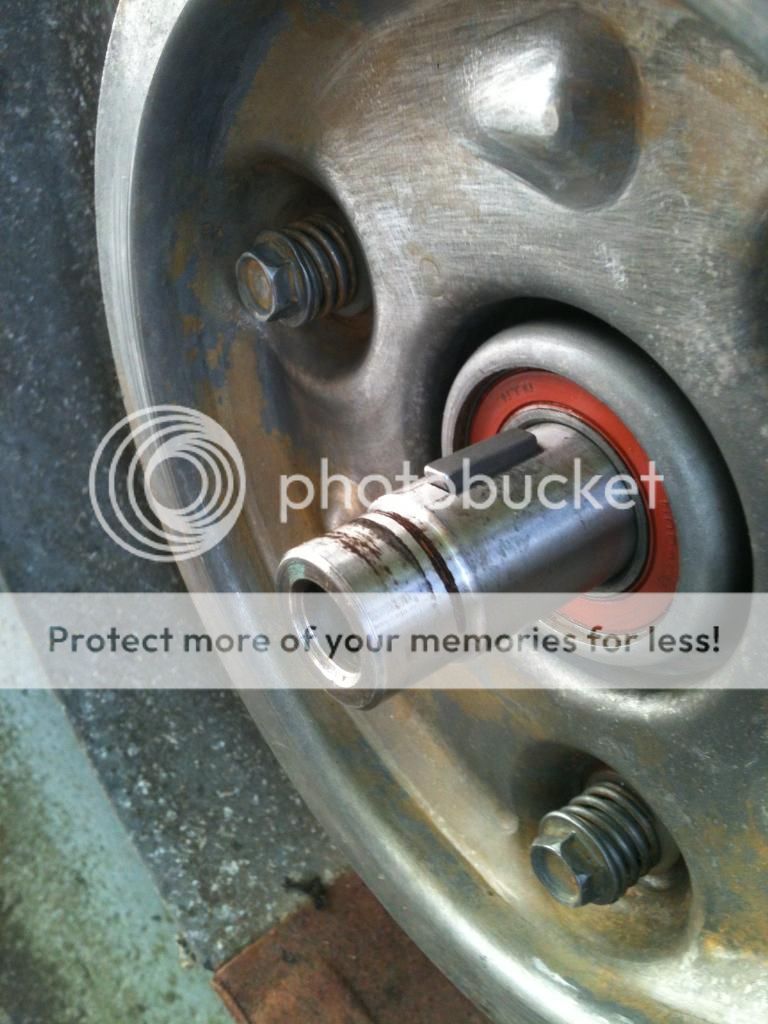

This pin is what links up with the pawl assembly to make it drive. The large disc behind it goes on with the cupped side facing out.
The wheel and pawl assembly slip over the end of the final drive shaft. A bolt holds them in place on the final drive. You'll most likely have to put a vise grip on the final drive to tighten, or remove a wheel as it will turn otherwise.
