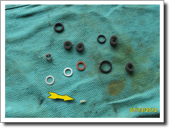

Update: Flywheel / key looks good. Adjusted the valves, which allowed it to turn over a little easier. Rebuilt the carb (60 smackers for the kit).
The picture below shows the remaining parts that didn't fit the carb and a little piece of tubing (yellow arrow). While cleaning it, this cam out of one of the passages. It appeared to be an almost perfect fit, and at first I thought it was supposed to be there, but on closer inspection it appears to have been broken off. It looks like it may be from a spray can nozzle.
Anyhoo, I finished cleaning and reassembling and reinstalled the carb figuring the piece of plastic was the culprit, but no such luck. It still spins and occasionally pops and coughs, but no joy. :confused:
