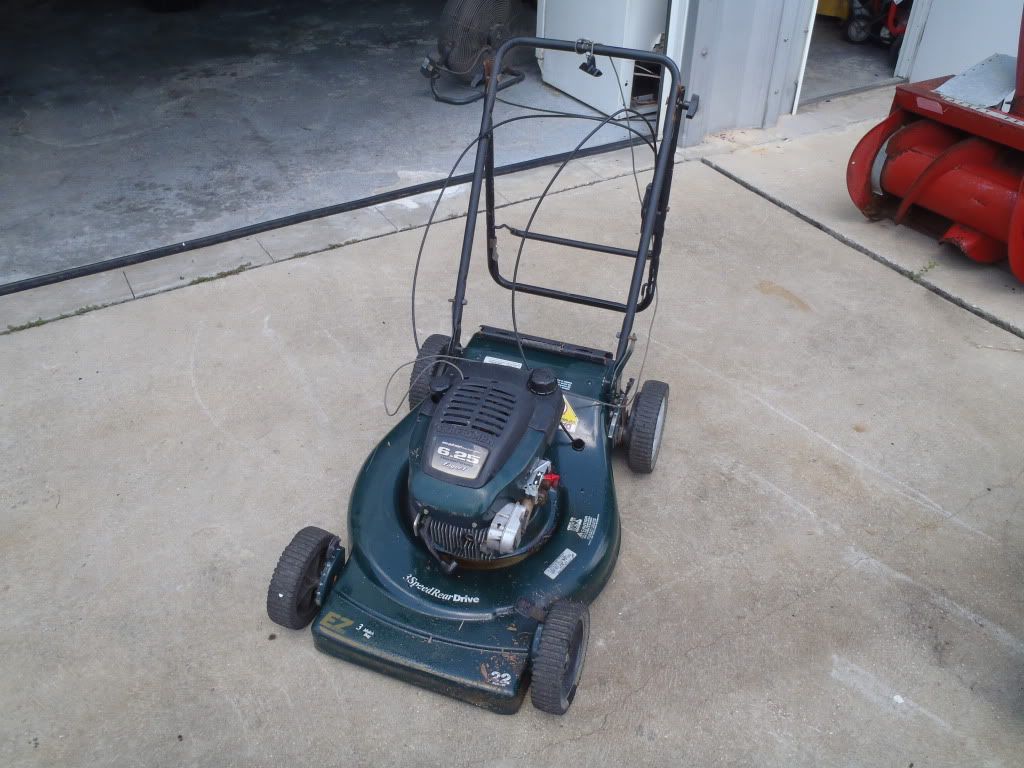

I picked this up from a garage sale for $5. No plug, oil all over and air cleaner missing.
Fresh off the truck

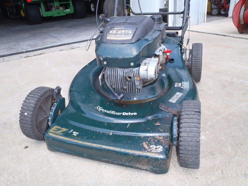

Close up of mess
Checked the oil and it was slightly over filled
This was the excess, almost a quart

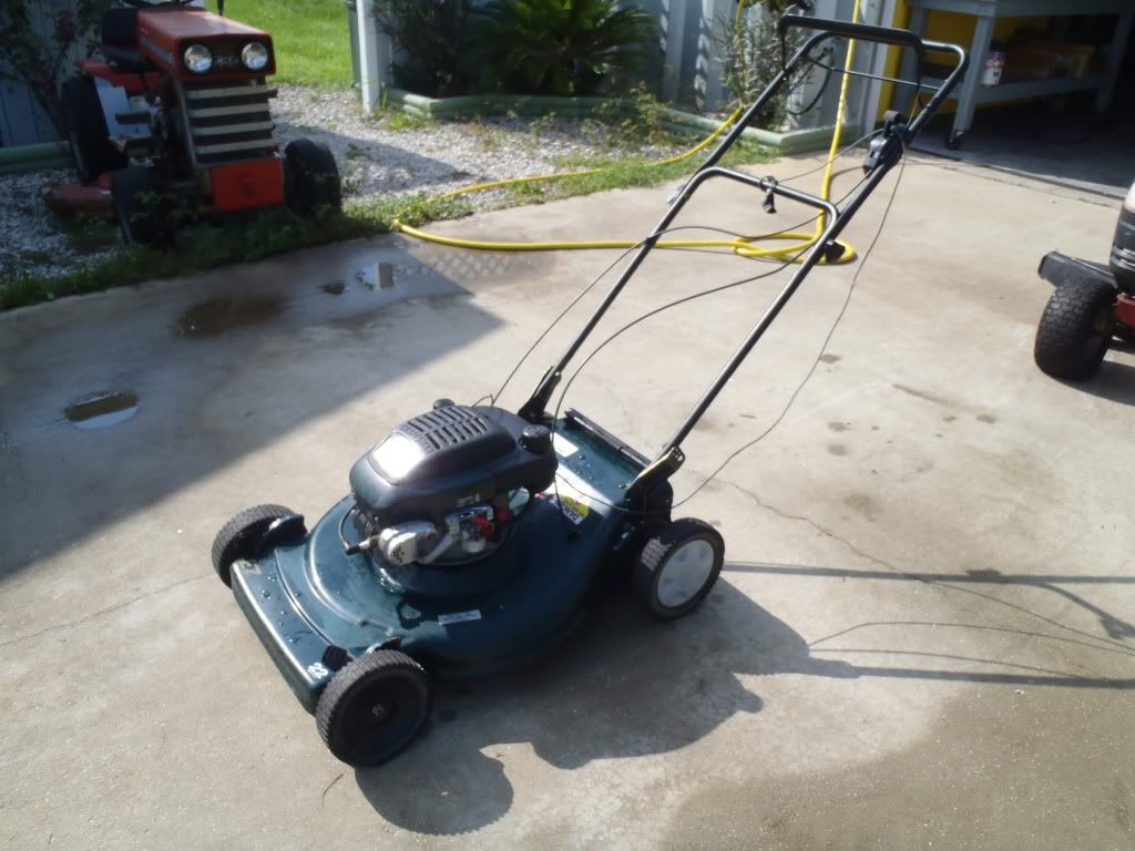

All cleaned up.
The owner had taken the plug out due to cylinder being filled with oil/gas and locking up on him.
What was the problem?
The brass float in the carb had a leak and filled with gas causing the fuel to leak past the needle and seat, through the carb and into the cylinder and eventually into the crankcase. This caused the oil to appear to be over filled and caused the cylinder to create a hydraulic lock causing you to not be able to pull start the engine.
A little lube on the recoil spring assembly and the cord rewound and works fine.
Rebuilt the carb with new float and replaced the spark plug and new air cleaner/filter and she's running fine.
