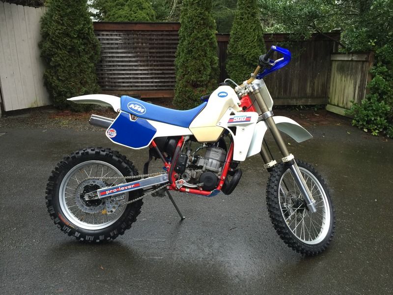

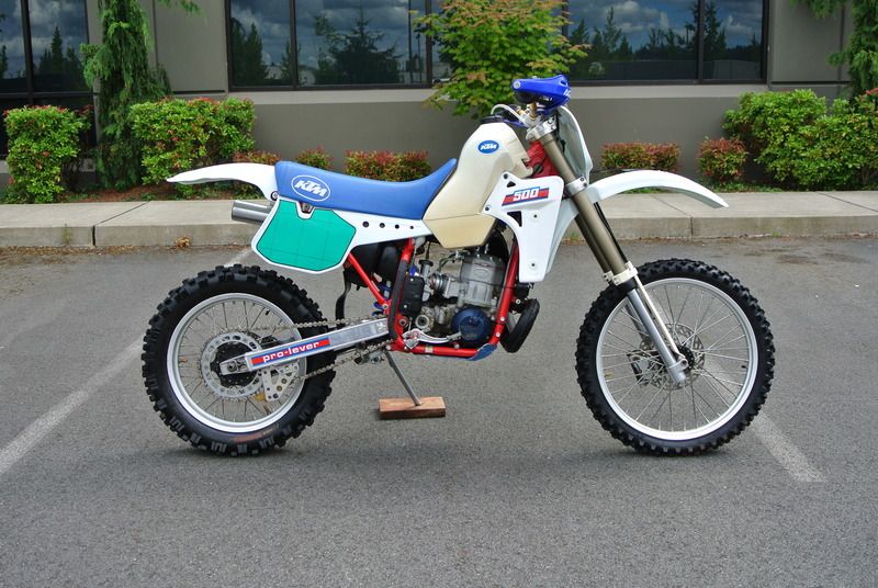

The old girl arrived safe and sound have been spending the past couple of days getting acquainted with it in the garage. I finally fired it up and took it for my first ride today. If you'd like to get a firsthand experience of what it's like, then you can read my review below after the pics.
The Basics
When you first throw a leg over it you realize how light it is. Really light. If you're used to riding two strokes and the weight wasn't so noticeable, the hard and unforgiving seat instead will catch your attention. It is probably partly this way due to its age. The gas tank is large and sits up high in front of you, but is unusually quite narrow and slim on the sides like an MX bike. Flick the kick stand up and you wonder if you almost broke it because it feels very light by the way it went up. You definitely feel like you're on something that's retro by the lines of the tank and style of the plastics, but the ergonomics are not so far vintage that you feel like you're on something from the early 70's.
You work the controls a bit to get a acquainted with their positions. The bar is nice and flat (it's actually an aftermarket bar) with a very comfortable reach that doesn't feel anything out of the ordinary. The Magura throttle system is quite heavy in feel with strong return spring pressure. Magazine editors back in the day had complains that it and the front brake lever required too much muscle to operate and could cause fatigue after a while. The clutch lever on the other hand (literally) is light. You then attempt to work the rear brake but you find that your boot rolls off the peg instead as if the brake lever isn't even there. What? The rear brake lever is somewhat oddly mounted inboard with the bike so you have to actually position your boot up and to the left in order to fully activate it smoothly. It's not mounted directly in front of the peg like most bikes so you realize you better work it several times to become comfortable with its orientation.
Starting it
This is where it gets fun. Kicking this thing over is downright scary; plain and simple. The good news is that it does seem to want to start (some bikes just plain don't and will fight you until the end) but it seems to actually be working on your side to do so which is good. You can either use your left leg, unnaturally, to do it while on the tall seat, or, kick it with your right leg standing off the bike while trying to keep it from coming off the kickstand at the same time. Whatever nonconformist style you chose produces a low and fierce sounding "glug glug" as you turn it over that growls through the exhaust like the echoes the clown in the movie "IT" makes in the sewer pipes. Stories you read of folks having their calves shattered in half or legs broken quickly dance in your mind. You ask yourself "what if" and question if the risk is worth the reward. You press on the lever about 1/4 of the revolution down just until it goes over compression. The feeling is like the kick starter all of a sudden engages what feels like a stuck rock that simply won't budge any further. I use the analogy of a rock because that's exactly what it feels like once the lever comes into compression. When you kick over a big 4 stroke and you reach compression stroke, it will still often feel somewhat "rubbery" with a tiny bit of give at that point. This... notta. Nothing. Zilch. The motor might as well be locked up solid. Even when you put your entire body weight onto the lever it still will not even budge a millimeter or give you any indication that it will. At this point you say a prayer, and jump on it as if your life depended on it with the hope that the lever doesn't spring back up with enough force that could land you on the moon. If your best Hulk impression still did not move the lever one or both of two things will have happened; you either put a nice gouge in the tread of your boot and/or the bike almost fell over.
If you think bump starting this thing is a second option, think again. I initially tried this but unless you are a heavy weight, it wants lock up the tire when you let the clutch out... even in 5th gear.
If you were successful with the kicker, the lever will have gone half way down its revolution and your ears all of a sudden begin bleeding with a very rewarding joy. I felt like I had just won a gold in the national Olympics when I fired it for the first time. The sound of it is VERY loud. POP POP POP, BANG BANG BANG, CRACKLE CRACKLE CRACKLE. You almost need ear protection standing next to it when it idles it is that loud.
What is it like to ride?
To be honest, I had naively been wondering just how "powerful" it was going to feel next to modern day machines and thus preparing myself that it may not exactly what I had been envisioning. I was just going to enjoy for what it is. Boy, could I have ever been more wrong.
I don't think I could ever post enough of those "yikes" smilies to justify this bike. It is hands down the SCARIEST bike I have EVER ridden in my entire life. I used to review motorcycles for a part time job and have ridden varieties from all over the spectrum. Forget 1000cc+ liter bikes. The acceleration this thing has is pure insanity to the tenth degree. Violent. Pure i-n-s-a-n-i-t-y. I was shaking after my first ride on it as if I had just gotten out of a cold shower. I have not even gotten past a 1/4 throttle yet as the bike just wants to explode out from under you. I'd describe it like a stick of dynamite. Again, pure insanity. Insanity! You almost ride the clutch on this thing more than you're on the throttle. As you give it a hair of throttle input it takes off like you're going down a roller coaster. Basically if you give it any throttle it says "oh, you want a piece of me?" You let off the throttle but then you don't slow down at all because it has hardly any engine braking. You reach for the brakes and while the front works, you totally miss the rear because of the akward positioning that you still haven't mastered yet. You've got a lot other things on your mind at the moment so you can forgive yourself for that.
As you're riding, you quickly begin to notice the heat from the expansion chamber on the left side begin getting hot so you have to swing your leg out to not burn yourself. It's hot, there's no heat shield, and it's easy to bump your leg on it which I seemed to repeatedly do. Eventually I'll get the picture. Surprisingly it is smooth in the low end, then as the revs build the vibes begin to come. Unlike some of the other 500 open classers of the time, this one came with a heavy flywheel which helps mask vibrations.
I go back to the noise because it is a lot louder than I expected it to be. The exhaust has a factory spark arrestor so it's not like it's running an open pipe either. I was even a little concerned this thing might sound a little too plugged up and already considering options of having a custom muffler made. Turns out you need ear plugs to ride it as the "BANG BANG BANG" makes you think there's bottle rockets going off inside your helmet. When it idles it's nearly as loud as a 4 stroke single that is running straight out of the manifold with no exhaust system. It's ridiculous, every part of it!
It is by far the most absurd and scariest machine I have ever experienced in my life. I can only wonder what the heck would happen if you were to fully open the throttle. The bike would probably shoot out from under you doing multiple backwards somersaults until it eventually crashed into some trees in the next state. I now understand why these are called "widowmakers."
Now for the serious question... will I ever be able to start it again? ;)

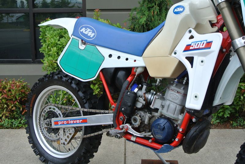

Better get your popcorn out because this installment is two parts in one. The first part consists of a series of more updates to the bike and secondly my first real exploration into the mountains with it.
Recently I took it out on a maiden voyage on some local trails with a co-worker who also rides. It was a good shakedown test to see if there was anything that I wanted to change before I took it on a trip. After the ride, I noticed that a couple of seals had blown where Permatex had been used so I placed an order with "Enduro Klassiker" in Austria that specializes in parts for vintage bikes like this and got an assortment of new gaskets where suspected gasket maker.

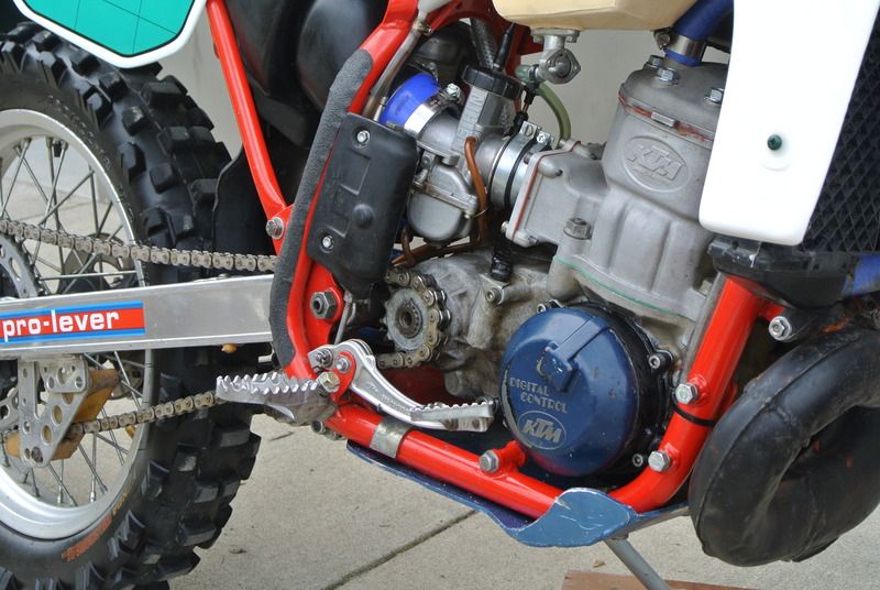

1. A nice trickle of smoke was puffing out from where the expansion chamber meets the head and sure enough the gasket maker had failed and blown out. The design of how the expansion chamber attaches to flange is not very good. It made sound weird, but using stretch and seal plumbing tape is what other owners swear by to use to solve the issue so that is what I did. No more leak.
2. Secondly, and more disturbing, I noticed some very small droplets of coolant starting to ooze out from the head "gasket." After I removed the head I found quite a few droplets of coolant scattered inside the cylinder as you can see in the photo below. It must have been losing a fair amount of compression here combined with the air leak in the exhaust; I'm surprised that it ran as well as it did. It most likely was burning some white steam mixed in with the smoke of the exhaust that I didn't notice. In any case, it turns out the head gaskets for these are made out of some extremely thin material, it is basically thinner than a piece of copy paper. This is why I it was tough to identify what was or wasn't in there before other than Permatex. I actually broke the one I bought when I was installing it so I said "forget it" and made my own new head gasket out of some very slightly thicker gasket paper.
3. Something else I came across which I thought was noteworthy. When I ordered all my gaskets for a '1986 KTM 500' the water pump gasket in particular, which I indeed verified is for a 1986, does not fit. After looking at some microfiches I discovered the left side engine/clutch/water pump cover is on my bike is off a later 1988-1996 500/550. I had to re-order a later style gasket so that it would fit. At some point early on in the bike's life, I imagine, the cover was swapped out for a later style. The original may have suffered bad cavitation early on and had to be replaced. When I opened it up, I did find some cavitation inside the waterpump so I did what was recommended to me on the KTM forum and filled it with a coating of JB Weld. The Evans Coolant prevents corrosion but I didn't want to leave the existing cavitation exposed. Someday when replacement covers are available I'll replace it with an aluminum version.

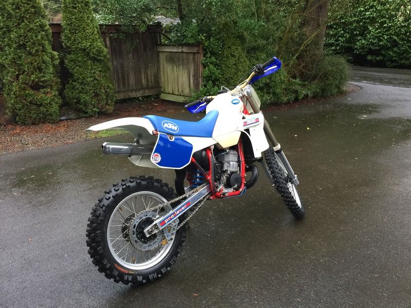

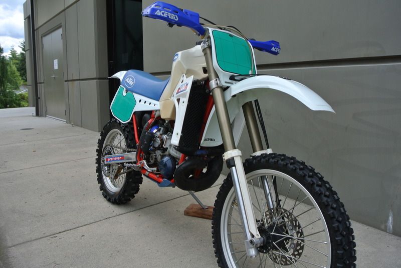

4. While the bike was torn down for a while I decided to change the graphics to green as seen in the photos below. I also purchased new OEM style Acerbis plastics from Andre (Enduor Klassiker) as well. I'll store the original plastics with the blue decals in case I ever want to go back to them but for now I really like the green.
5. I also found a good used four pot rear brake caliper on Ebay from a later year KTM that will swap over. I plan to also install a more modern front master cylinder to provide increased braking power and will do that all at once sometime.

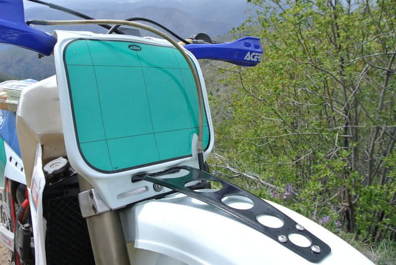

6. I also installed a new front fender brace support which was an option for these bikes originally. I think it adds another little bit of retro bling.
I had to modify the mounting a bit for it to fit.
7. During the same time period in the 80s, some of the smaller CC KTM dirt bikes came with these cool, stylish, magnesium ignition covers. I found one on Ebay and took my chances with it in terms of fitment, however, it seems to have disappeared in the garage!! I don't know where it went and still can't find it.... sooo odd to lose something like this. Anyway, when I actually did have it in my hands I discovered that it has a slightly different mounting bolt pattern than a 500's (of course) which is kind of a shame. It would actually mount if you were to flip it upside down however but that wouldn't look right. Really the only way that I can see to make it work would be to cut the center out of the original cover which would leave you with a mounting ring that you could then glue onto the mounting surface of this cover. Voila. I would also shave off the mounting tabs on this cover if I did go that route. Might give it a try in the future if I'm feeling ambitious. If you have any other ideas in terms of how it make it work before it's too late, let me know!

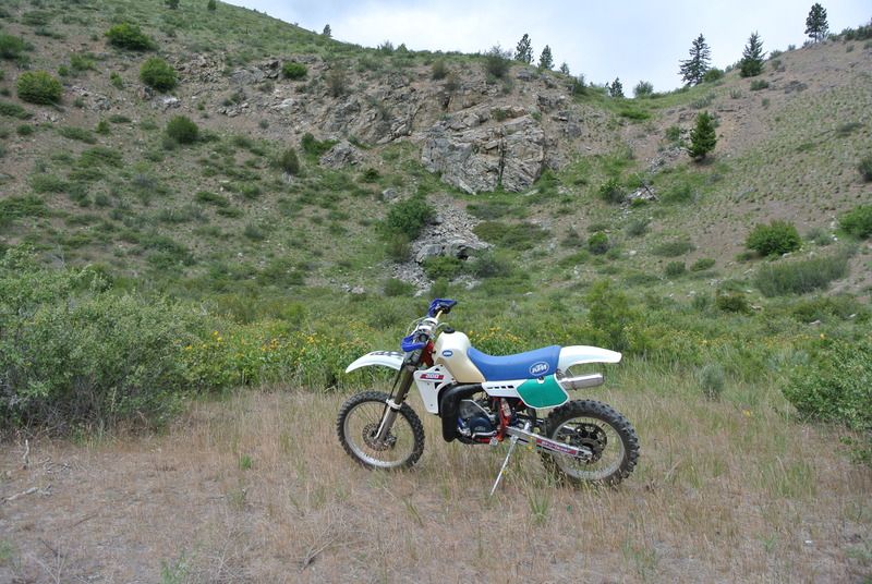

This is what I call the "burnt forest." It was quite an interesting sight. All of a sudden you just enter it. There was another person there taking photos too when I was passing through.
The 'look out. I had officially made it to Cooper mountain at this point. It was only 13 miles on the odometer but figured it'd be a good time to do a fuel check. I was almost dismayed to see that I was nearly at half a tank already! WHAT!?? If I had been on any of my former 4 stroke dual sports at I would have still had a full tank at this point.
I had a realization that because of the level of performance this thing pumps out, it's really not hard to understand why it goes through fuel so fast and I shouldn't complain about it either. You can't get both. This thing is not a dual sport, but that's not what I was hoping or wanting it to be either. I had kind of always thought it was my imagination when I'd notice a change in the fuel level after a short time running it a bit at home. I wasn't- it just goes through fuel that fast. These bikes came with an even small tank designed for MX tracks. This one has the large 3.1 but still has a limited range. I estimated it gets between 13-15 MPG.
I was feeling hungry and this seemed like a nice spot to stop. It is sure different that riding a four stroke going down hill because there's zero engine braking. I don't like coasting for long distances on 2 strokes without applying any throttle so it was a balance between using lots of brake input with little inputs of the throttle periodically at the same time.

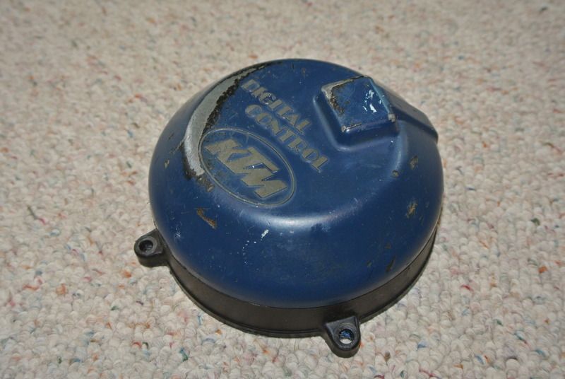

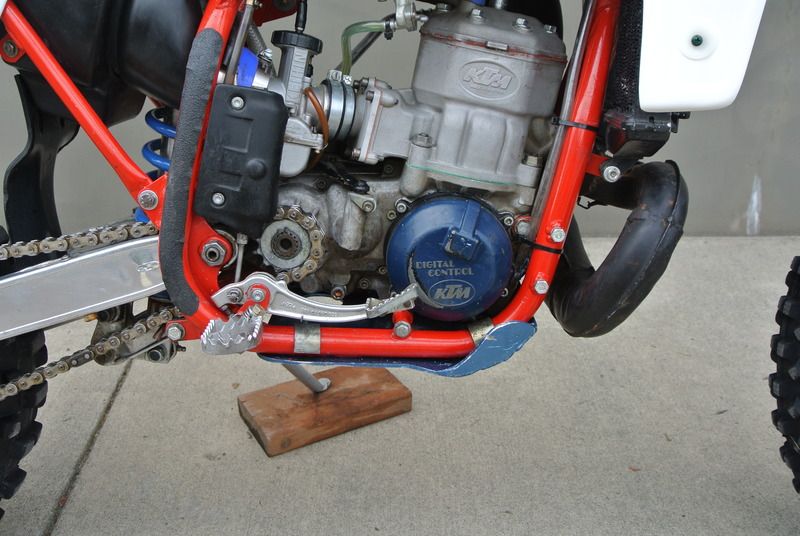

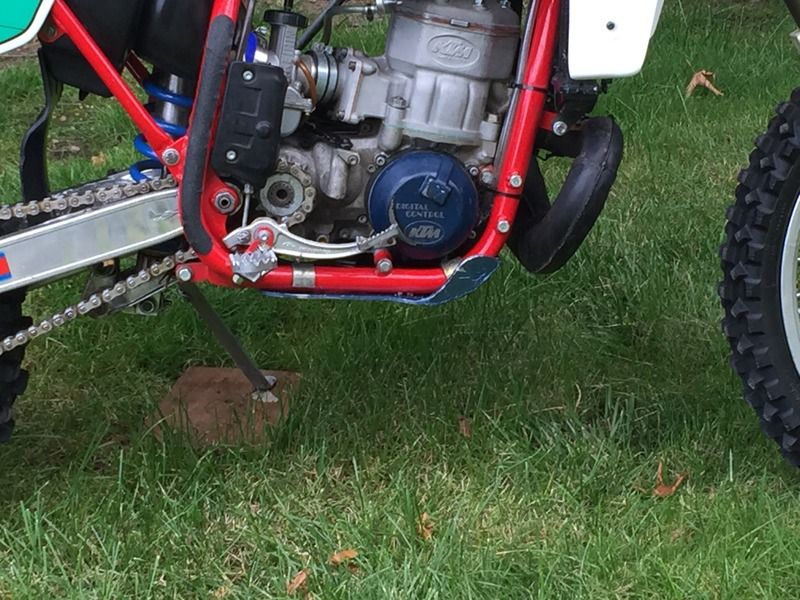

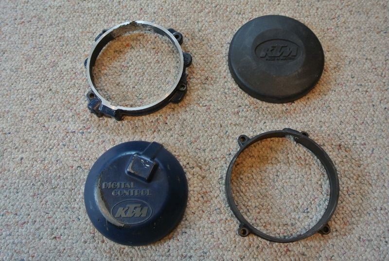

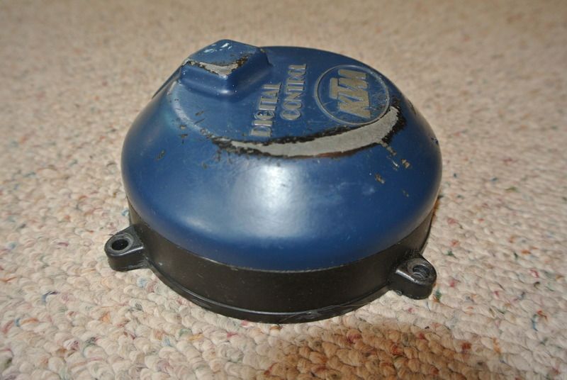

During my on-going research of 1980s KTMs, I discovered some of the < 500 displacement CC models (it may have only been the 250 model... I don't really know for sure) came with these really cool retro looking, magnesium, flywheel covers. "Digital Control"- These things are awesome!! From what I've seen, this same cover was not ever offered on the 500 which was treated to a much more plain/basic plastic flywheel cover in comparison pictured on the right above. Being a sucker for things like this, I had to at least try to see if I could somehow make one of these work on my bike.
I did some research and these covers seem to be typically listed in the $50-$85 range and saw some listed well over a hundred on some independent websites. I eventually came across this guy going cheap for $19.99 because it had some corrosion issues so I figured it would be the perfect one to experiment with and chop up. The question was how I was going to do it- more on that. When I initially got it in my hands, I discovered the bolt pattern was wrong for a 500.... of course.... (although it would've actually mounted upside-down) and the cable guide slots that you see molded in it are non-relevant to a 500 as well. The good news is that the cover is the right size to fit over the 500 flywheel.
After looking at both covers side by side, I devised a plan to make one cover out of both of them. This would be done by cutting off the non-relevant cable guide portion of the magnesium cover; the cut was made where you see the white line. The stock cover would then be trimmed off and then the two would be joined together via epoxy. This way I would still have the correct mounting plate/face of the original cover to mount to the bike but have the magnesium cover (or cap now) for the front side.
The big question was how I was going to cut the magnesium cover in a professional (and safe) manner. Good luck taking it down to the local machine shop and paying them a quarter of your monthly earnings to make a single cut. I had remembered our good friend and member, Ellis, (tiretrx) who had helped me out with another project a few years ago. I hesitantly asked him if he'd be interested in taking this on fully expecting him to say "get lost!!" :Ugh: after I explained the good for nothing project to him but instead he said send it on over! I couldn't have done the project without him. One of the things that is so great about Ellis and his machining services is that he understands our hobby so he's willing to go the extra mile to help us out at realistic prices. I couldn't recommend him higher! Thank you again, Ellis!
Was it worth the effort?
You know, I didn't know how it was going to look after it was mounted on the bike. If it turned out looking like any one of my many failed arts & crafts projects when I was in grade school, then I had every intention for it to hit the trash and be replaced with a new plastic cover. The idea on paper was that it would sort of match the magnesium clutch cover on the other side. I think I'm happy with it, it's sort of a funny idea I guess. It would probably look more pronounced if it was repainted.

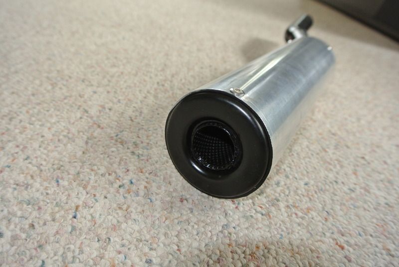

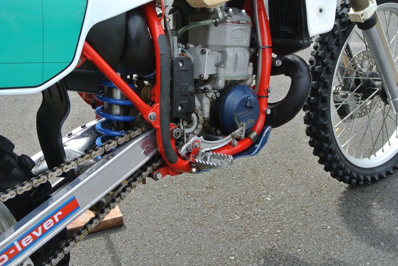

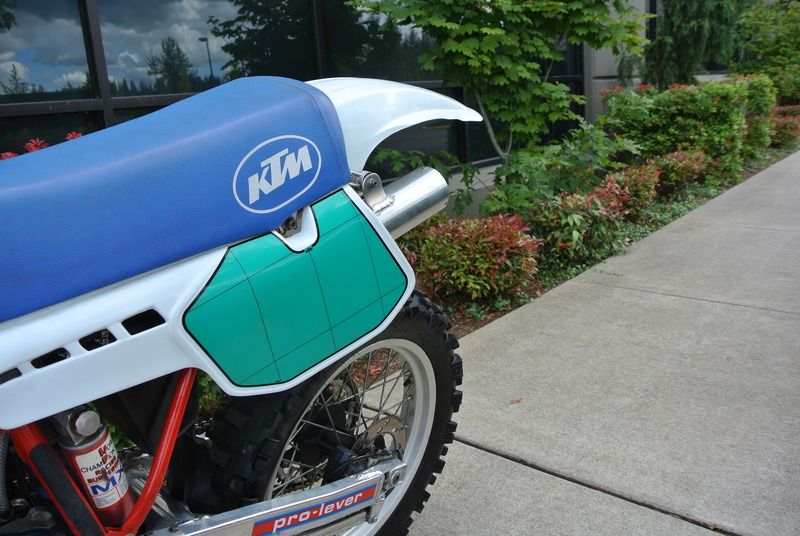

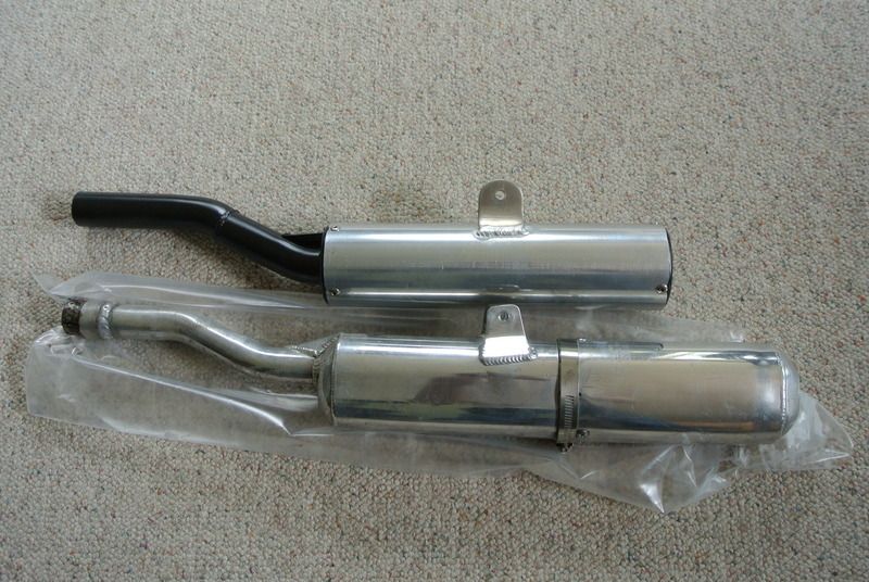

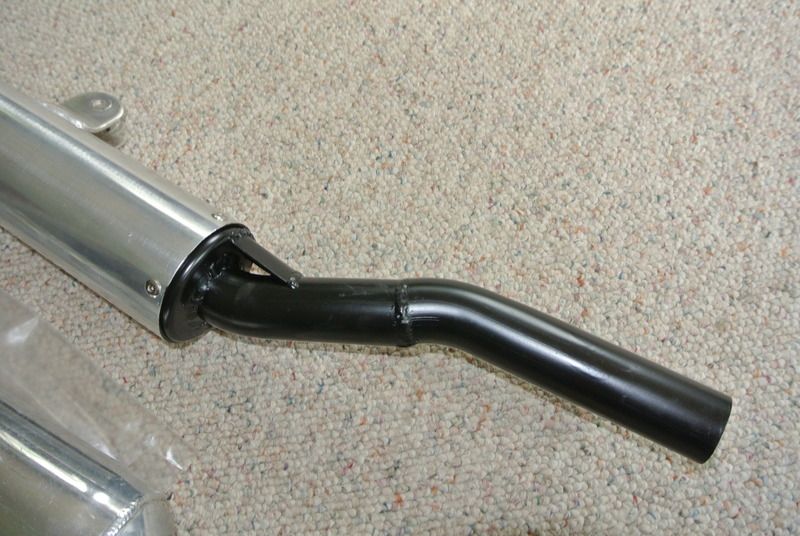

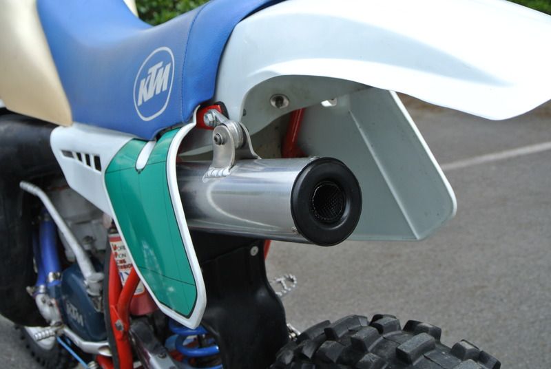

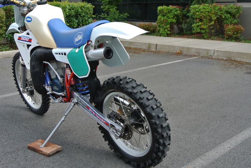

2. I purchased a new Dynoport "Big Barker" muffler from Rich Daly, the owner of Dynoport.

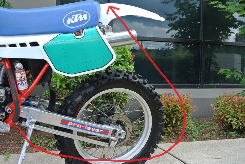

Out on my last ride in the mountains the brake rod ended up losing one of the mounting bolts which made it flip up and shoot a hole right through the fear fender locking the up the rear tire at the same time. I thought the motor locked up when it happened. As the rod shot up, it apparently also put a small dent in the rear end of the muffler which was unfortunate but it gave me an excuse to get a different one which I was tentatively planning. While I was out on the trail when this happened, I removed the rod from the bike and rode back to the truck using just the front brake and fortunately had a spare bolt and nut that was the right size so I could remount it and continue riding with both brakes. It proved to me the importance of bringing extra tools and hardware along for this bike.
Aside from the damaged rear fender (already replaced) and muffler, there was no further damage to the bike. The remaining bolt that had been on the brake rod at the time of the incident was tight and had a nylon lock nut on it but I'm guessing the one that worked its way out did not. In any case, I replaced the mounting hardware on both ends with new locking hardware as I don't want that happening again but will still be keeping an eye on them.
Surprisingly the new muffler really isn't any lighter than the stock one.
Made a new joint connection
The original muffler was not straight-through like this one so I was wondering just how much louder it was going to be. The tone itself didn't really seem to change but the "bang bang bang" is louder. It was loud before but now it hurts your ears standing next to it while it's idling.
3. Air filter fitment: Before my last trip, I did a visual check of the air filter and it looked nicely oiled and clean so I left it alone. I could tell that it was a dual stage aftermarket and not the original which I thought at the time was a bonus. After I got back from my last trip, I pulled the seat and it was dirty enough for a cleaning but as I was removing it I discovered that it sat against the air box too loosely. The problem was that the air filter was simply too big for this application. No matter how I tried, it just did not make a good seal even with filter grease. I wasn't thrilled when I found this out. I learned on a forum that Suzuki DRZ400 air filters will work as a replacement and I actually happened to have a stock DRZ air filter from when I had one of these bikes. I found the DRZ filter is indeed smaller than the aftermarket one so I put it on the bike and it is a much better fit and seals tight like it's supposed to.

Okay, I'm kinda confused. You said the brake rod came off, but it looks like it's cable operated. Do you mean the lower strut rod that holds the caliper assembly in place?
I kinda like the mag cover! :Happy:
Reactions: 1
That would be it, "brake rod" for lack of a better term.
Below is a line with an arrow showing the path that it took when it came loose and went through the rear fender. The caliper twisted all the way around the disc from it's normal position when it happened.
lol, thanks Nico.
I actually took it off today and broke the epoxy loose and reattached it. I saw in the pictures that the lettering was slightly off center so I reattached it so it's now straight. Sometimes it's not until you see things in pictures that you see things they way they actually are.

Nice upgrades to make it yours Austen! I like the cover and the muffler! Need video for sound now! ;)
Reactions: 1
2
Thanks Eric, I will. I'm pretty curious to see what it's putting out in terms of decibels now at idle so I'll turn the i-Phone decibel app on and get an estimate. I'm guessing it's gotta be around 100 decibels at idle.
Got the cap centered.... it was bugging the heck out of me seeing the lettering slightly off center in those photos.
Here's a couple of pics that Ellis sent me of the machining. Below is a quote from his as well.
This one was pretty straightforward.......as to the magnesium cover. Chucked it up on the ID, added some coolant, and put a .160" wide parting tool to it at 350 rpm's. Cap dropped like an egg into the nest.
The plastic version was chucked on the ID, but due to the amount of flex the part had, it had to be done gently. Actually turned the RPM's up to 500 to go for a freer cut, but dialed the feed rate down to a couple thousandths for rev. When I got it almost through, I unchucked it and finished the parting by hand with a deburring tool.
Here's a short video of it running, Eric.
I turned the i-Phone decibel app on, shot it at the bike got, and got a max reading of 96 and a peak of 95 decibels on each fire while idling. The engine is cold when I took this so it's a little more smoky than when it's warmed up. The distance of each pop you see out of the exhaust gives you an idea of the compression.
